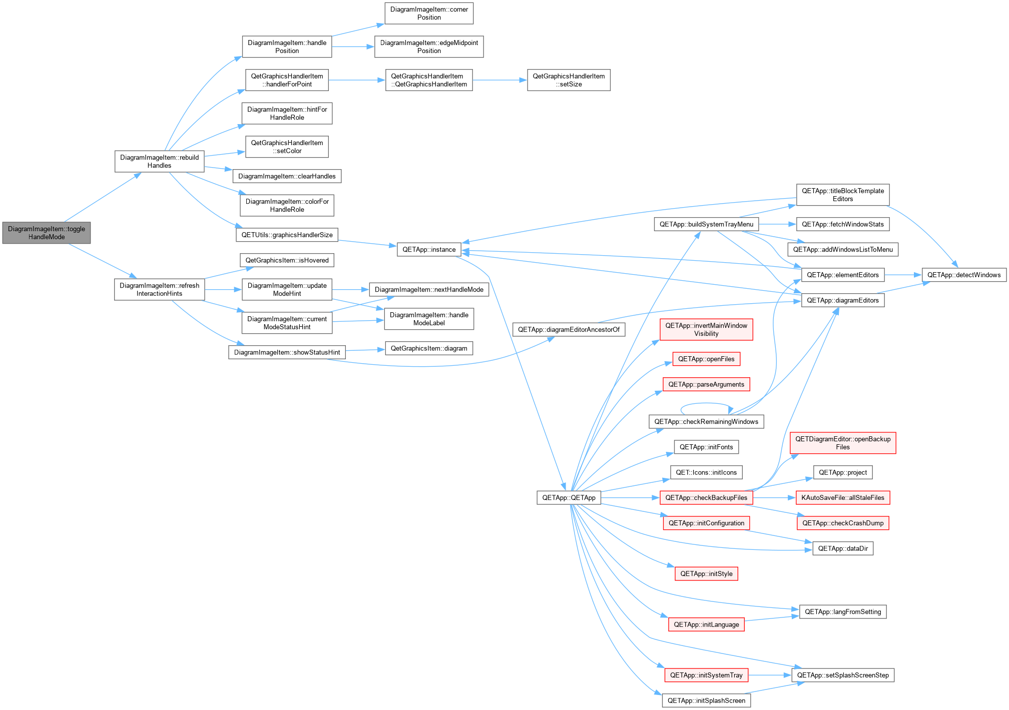

DiagramImageItem Class Reference
#include <diagramimageitem.h>
Inheritance diagram for DiagramImageItem:
Collaboration diagram for DiagramImageItem:

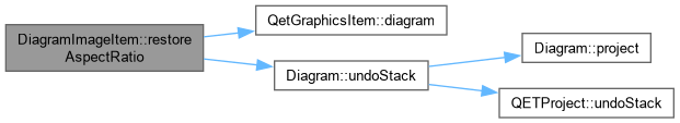

void restoreAspectRatio ()
 DiagramImageItem::restoreAspectRatio Context-menu action, the direct answer to "restoration of aspect ratio" from the original wishlist: makes scaleY match scaleX, keeping the current width fixed. The natural aspect ratio is already fully accounted for by the pixmap's own width/height (a uniform scale, by definition, can never distort it) – the distortion is entirely scaleX and scaleY disagreeing with each other, so undoing it is exactly "make them agree", not a computation involving pixmap_'s own dimensions at all. An earlier version of this multiplied by the natural height/width ratio a second time, which double-counted it and left the image still visibly distorted, just less obviously so.

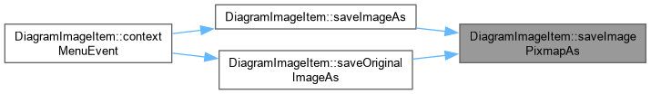

void saveImageAs ()
 DiagramImageItem::saveImageAs Saves the currently displayed pixmap (crop and colour-keyed transparency already applied – what the item actually looks like on the diagram, not the pristine original) to an arbitrary file on disk.
void saveOriginalImageAs ()
 DiagramImageItem::saveOriginalImageAs Saves m_base_pixmap – the true, pristine original, before any crop or colour-keyed transparency – rather than the item's current, possibly-cropped-and-keyed display pixmap. The only way to recover the un-cropped, un-keyed source once either of those has actually been applied, short of undoing every edit back to the point it was first inserted or replaced.

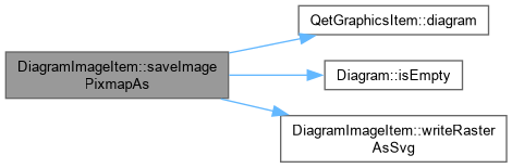

void saveImagePixmapAs (const QPixmap &pixmap, const QString &dialogTitle, bool hasTransparency)
 DiagramImageItem::saveImagePixmapAs Shared by saveImageAs() and saveOriginalImageAs(): prompts for a destination, resolves whichever format was actually intended, warns before silently dropping transparency, and writes the file. A read-only export, not an edit: doesn't touch diagram()'s undo stack, and works even on a read-only diagram, unlike every other action in this item's context menu.

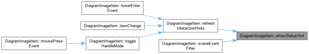

void refreshInteractionHints ()
 DiagramImageItem::refreshInteractionHints Keeps the tooltip text current, and – if already being hovered – immediately re-shows both the tooltip and the status bar hint rather than leaving them stuck on whatever was true before. Ported from QetShapeItem's identical method, for the identical reason: Qt only re-evaluates a tooltip, and this class only re-shows the status bar, when the cursor moves – selecting an image (often clicked while the mouse was already sitting on it) or cycling handle modes (definitely clicked while sitting on it) both change what should be shown without the cursor moving at all.

void showStatusHint (const QString &text) const
 DiagramImageItem::showStatusHint.

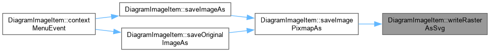

static bool writeRasterAsSvg (const QPixmap &pixmap, const QString &path)
 DiagramImageItem::writeRasterAsSvg Wraps pixmap as a base64-embedded PNG inside a minimal, valid SVG document – the closest this can honestly offer to "save as SVG" given this item only ever holds raster data (see the note in saveImagePixmapAs()). Opens in any SVG viewer at the pixmap's own pixel size, but is not, and cannot be, a vector re-export.
